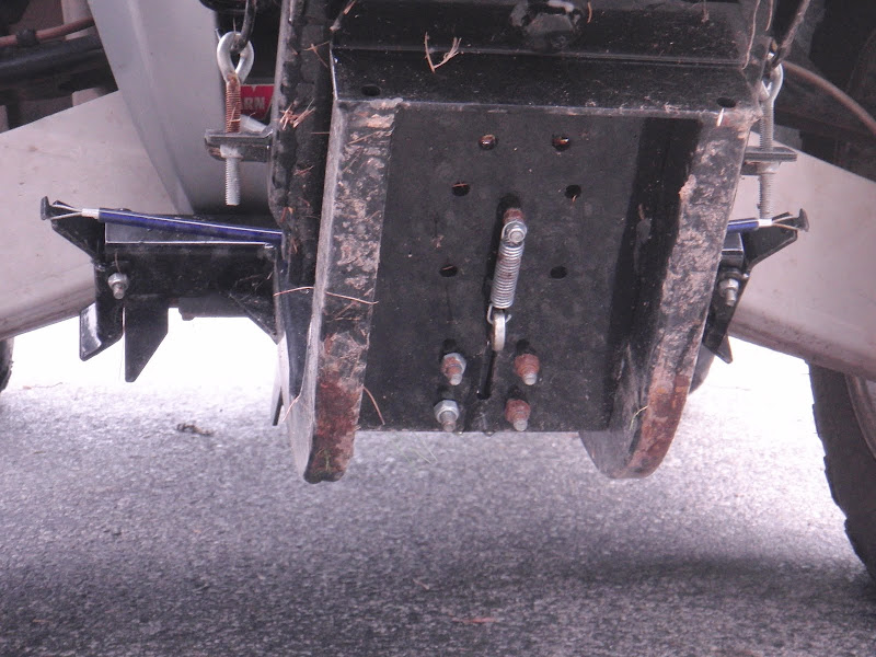

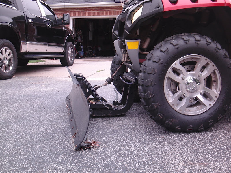

I have a 2010 sportsman xp 550 touring ,We installed polaris G2 plow. The plow frame arms rub the ground and causes the blade edge to raise up a little. Any suggestions?

That is the issue with the G2. Only way to fix is to cut the tubs several inches and re weld it so its on a angle. 2nd option is to sell it on craigslist and get a Warn front mount!

did u jack up ur suspension it will help some
i took some scrap aluminum angles that i had and screwed them in to the bottom right where it angles they might not last really long but atleast the frame isnt getting worn away
also i have 28" tires so it puts me up alittle higher for more clearance
if it still wears out bad im gonna get some heavy duty springs and see what happens
have yet to plow with it but i think it should work out good

Great advice I got some 2 in spring spacers on e bay I will try first .Cutting and welding mite be my next option. I dont plow a lot just want the plow to ride level If the frame rubs so be it.

adjusting ur cut to a more aggresive angle will help to get the blade alittle lower
