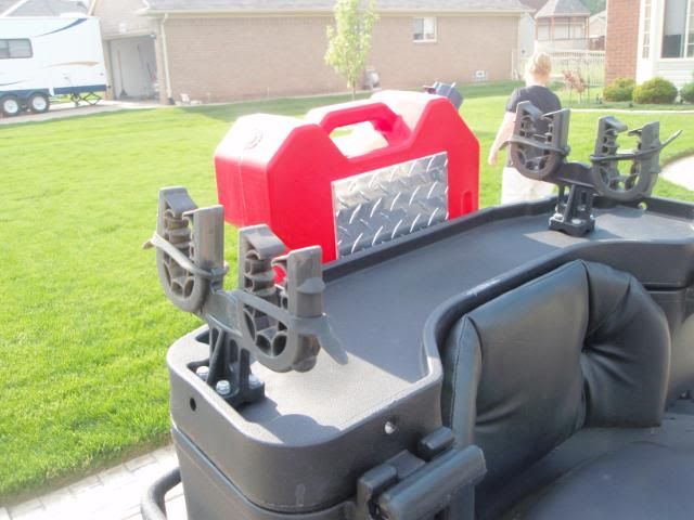

Originally Posted by 4x4guy View Post
Just got my 3 gal Rotopax.
Going to mount it on the rear Polaris hard box on my 10' 400 HO.
Need to make an upright bracket so that I can mount it verticaly with the bottom resting on the rail extender. Don't want to lay it down because I have upright supports mounted to the top of the box already for carring my ice auger or my bow. Just neeed to get the metal and drill a few holes.
Pics to follow.
I went with the Rotopax because of all of the positive reviews.
A little more ca$h, but what is it worth to you when you are out of gas and find the can which is mounted behind you or in the storage area empty because it leaked.
Finally got the bracket and can installed. Got a good workout this weekend and no leaks or other issues. Very Pleased !

Hey 4x4guy I like your fuel can set-up. I’m looking at doing something similar for an XP850. Is your bracket just a piece of aluminum bent 90 degrees so the base bolts to the rack and the vertical portion mounts the fuel can? L shaped bracket? If so does the bracket flex or vibrate front to back when riding?

You could bend it 90 degrees if you would like .Mine is just a straight plate with no bend. I found this diamond plate aluminum at a metal shop. It is about 1/4 " thick, 8" x 14" . I mounted it with 1/4" bolts to the back of the lock and ride box, then I mounted the can holder to the plate. I was going to rest the can on top of the rear extender rail but it was to high. I cut the extender rail out wide enough so that the can would fit in between the new cut ends. It now rests on the original rear deck . It went for quite a workout this last weekend and never moved or leaked. I was very happy to see that. It is a little snug to open and close the top lid on the rear box, but it does work. It could be extended about a 1/4" from the box with spacers, this would make it easier to open the lid, might just do that.
Worked out great so far. Rotopax does have a 90 degree mount that might work for you.

4x4guy, thanks for the info. I overlooked that info in your post were you said you cut the rack and the fuel tank now sits in between the cut ends of the rack and is supported on the bottom by resting on the rear rack.
That’s what I’m trying to accomplish, give the fuel can some support so it does not flex back and forth. With gas weighing approx 6 pounds times 3 gallons plus the weight of the can and the bracket that’s 20 pounds and I’m sure on a basic 90 degree steel bracket there will be some amount of flex almost like a springing affect. Your idea looks like it will work good now that I went back and re-read your post.
