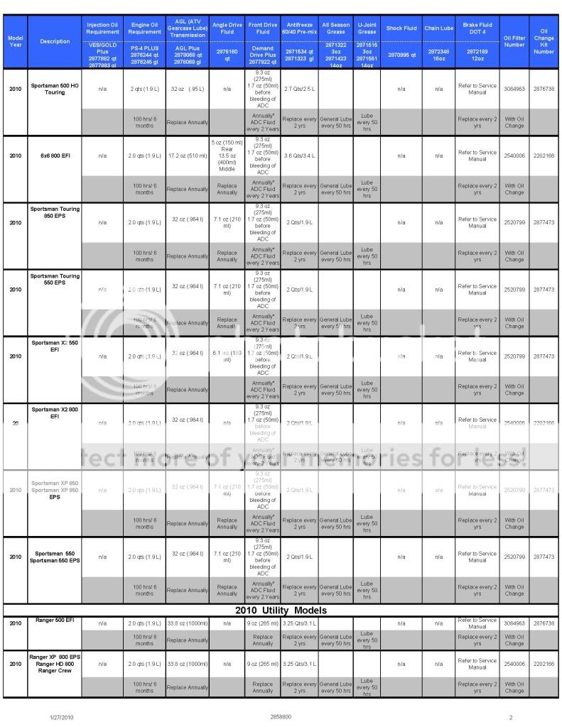

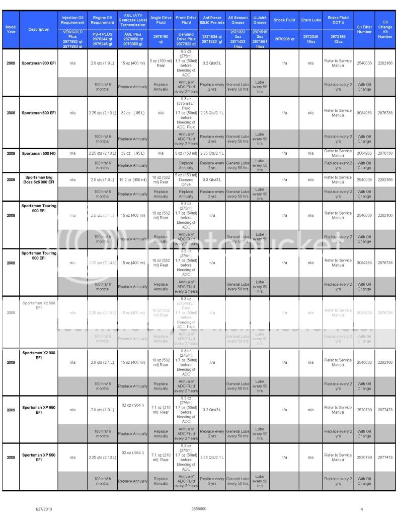

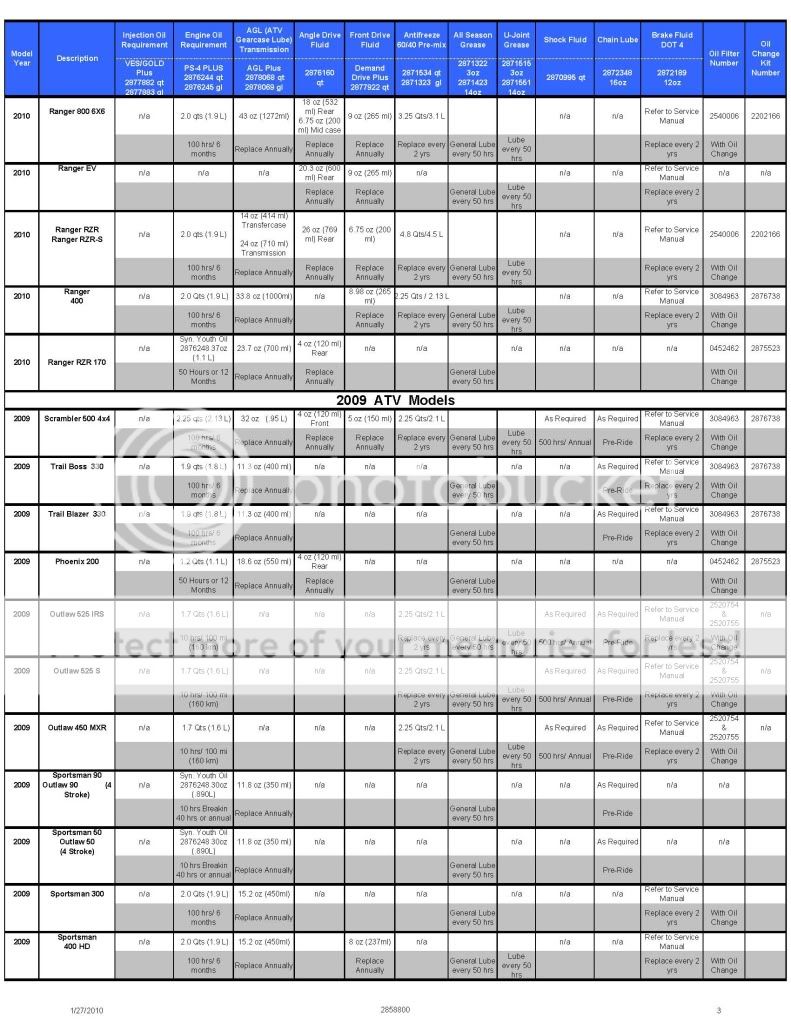

Lube Chart for All Polaris ATVs
this should help clear up some questions. i just found this and thought it would be beneficial to post up.
