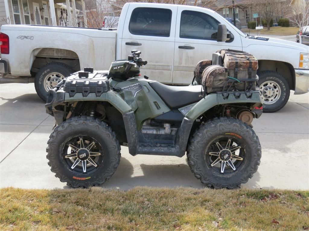

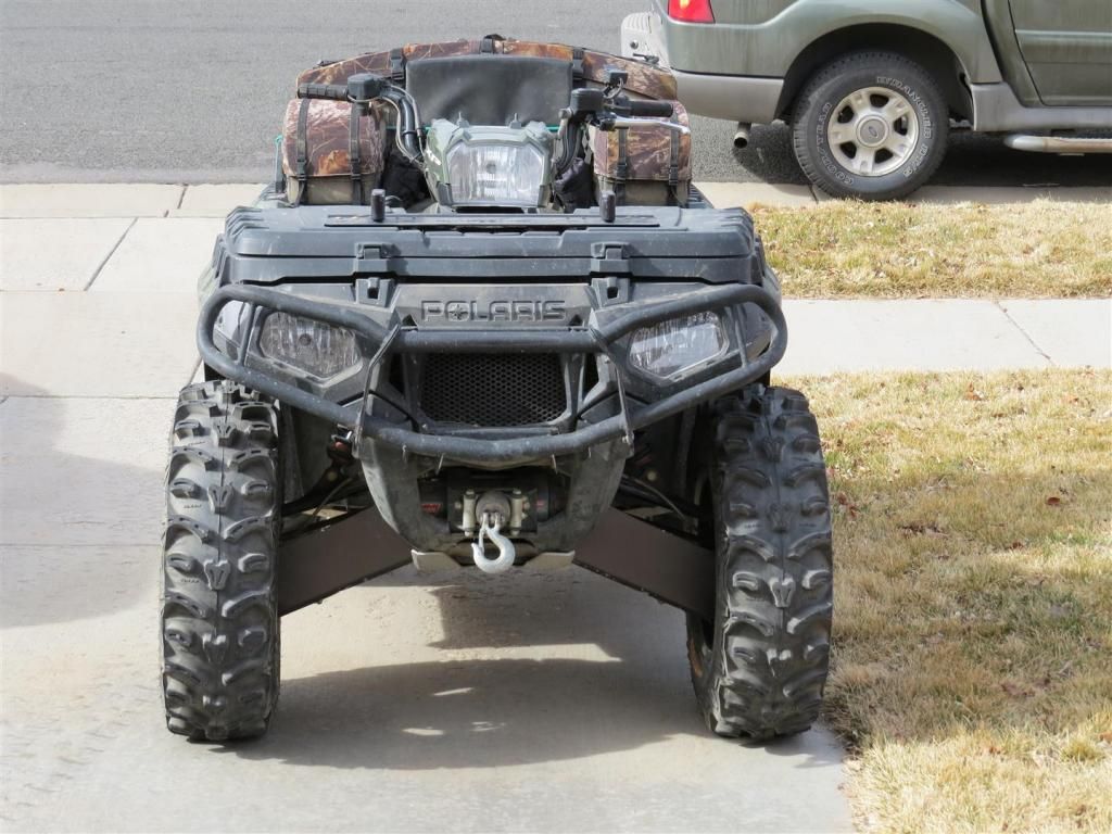

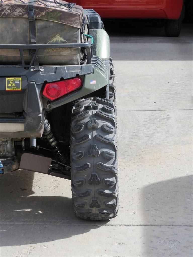

Got the new HTR's mounted up this morning. I gained a full inch of ground clearance with just 5 psi in the tires, compared to the 8-9 psi I was running in the Rockers. Should make for a much smoother ride over the rocks, and with them being a 28" tall tire, my issues and worries about pinch flats should now be gone. I now have the same amount of sidewall to play with that I had with 26" Bighorns mounted on 12" wheels.
I can also take some of the preload out of my Elka shocks if I want to and soften up the ride even more with the extra ground clearance I gained. Just need to get it out on a couple of rides to fine tune the tire pressures and shocks.
My only complaint right off the bat would be that they run a little narrow. The 11" wide rears measure 10" wide, and the 9" fronts measure 8 1/2" wide. I really can't imagine that will make any difference other than the look. If anything, it will probably handle a little better with the narrower tread widths.

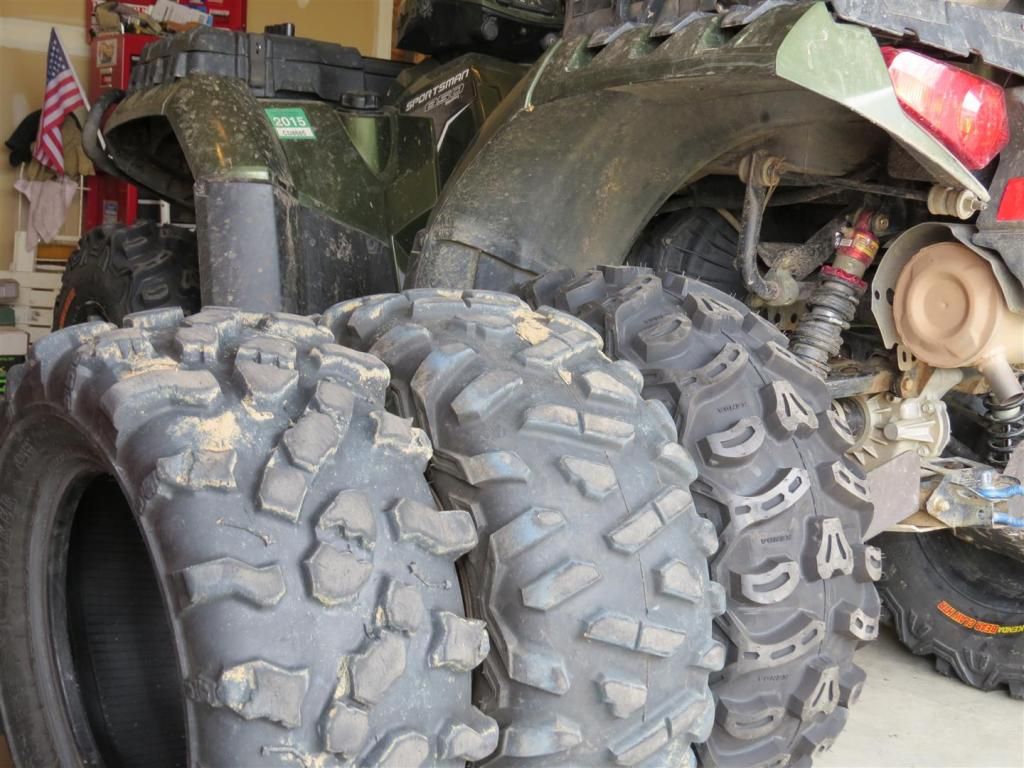

All three are advertised as 11" wide. My 26.5" Rockers and 26" Bighorns both measured the same height when mounted. In this shot the BH is still mounted and the new HTR has the weight of the machine sitting on it, so the height looks a little deceiving.

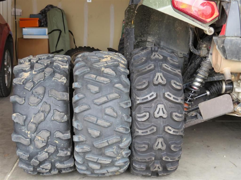

Here's the fronts with no weight on them. Now you can see the height difference between the 26" BH and the 28" HTR.
