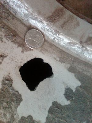

How do you break a bead on a tire with a bad rim? I want to take my rim in for repair and use it as a back up.

Try??????????? Get a bit of rubber say a pushbike tube and a small piece of wood{Large enough to cover the hole but not to wide that it wont contour with the rim ) then use a small jack to clamp it {push it tight )on the rim
Hope this helps out
