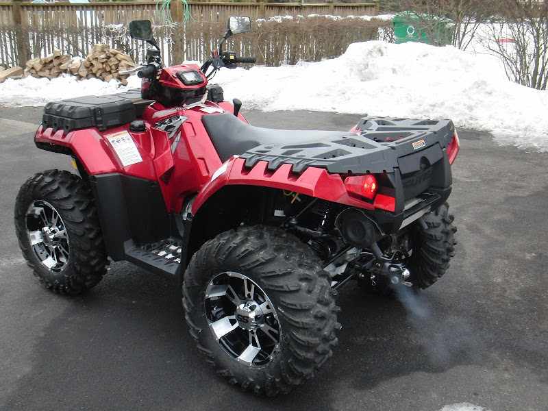

Here are pics of my old tires/wheels. I ended up selling them. Too wide and I was getting sick of all the mud that they would throw on me vs stock. If I do it again (which I may since I can not find a used XP rim after blowing mine) I will go with the front offset on all 4 next time with the different front and rear tire size.
