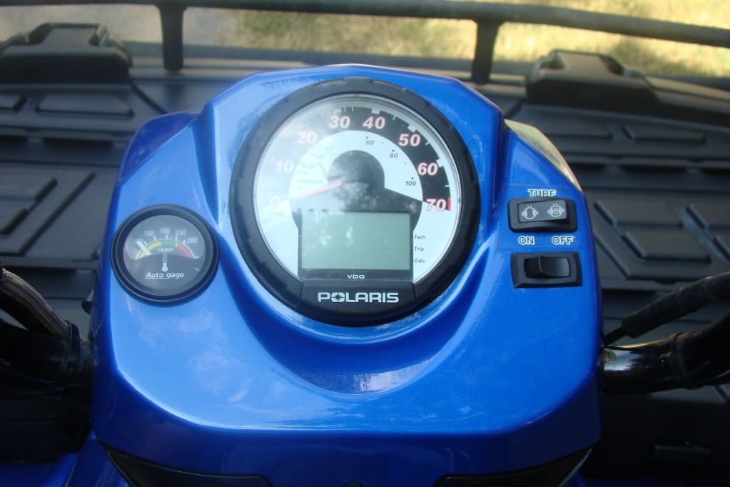

this is what i did.. helps let me know before trouble starts..

Yep, yep. I added a temp gauge as well.

I like the temp gauge, makes me wish i had one. I don't know why we have this smiley, but okay... Wondering, what the other buttons do.

The thermostat housing needs to be drilled and tapped for the sensor. Quadovator makes a kit that comes with a pre-drilled housing, gauge, and all wiring needed to install for around $70. That's what I bought because I didn't feel like tapping the housing (just being lazy).
Polaris ATV Temp Gauge Kit Coolant Switch Illuminated System Quad
As for the other buttons, the top one is the "turf mode" switch (stock on my quad), and the lower switch is one that I added to have back up/ work lights. When the switch is in the left position, they work when I'm in reverse, right position is constant on (work lights), and center is off all together.
