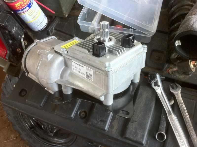

I have seen a few complaints about play where the steering box slides into the splines on the lower steering shaft, I drilled and tapped it for a set screw, so I don't ever have to worry about that problem.
Here is the Steering Unit itself, mounted to the bracket that turns it 90 degrees so teh motor points into the right wheel well instead of the fuel tank.
