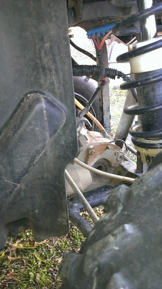

well since im getting so deep in on this 250 dollar purchase, i figure il make a seperate thread for it, so here it goes!
traded an old shotgun and 250 bucks for a 2006 hawkeye 300 4x4, but it needed some work
first major issue noticed, no front prop shaft or cv joints.:hmmm:
more to come tearing it down to see what i have

got the diff apart, jeesh wasnt there supposed to be oil in this?
well cage is good, gears are fine, basically needs a cleaning, bearings, and seals, and hopefully be ready to rock and roll
