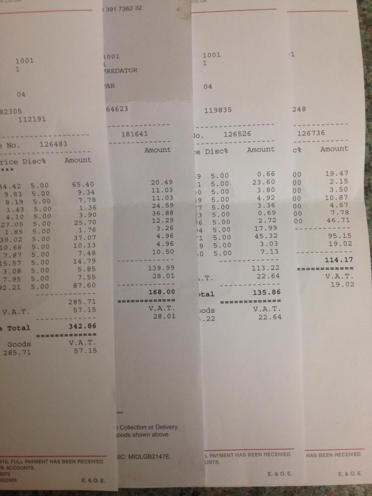

I've currently spent £1700 on it so far !
Here's some receipts for some of these parts.
