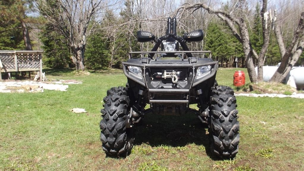

29.5 x10 terms, ran stock axles, no probs great tires.
31x9/11 OG outlaws, lift added with turners, no probs.
Terms are better everywhere except the mud.
Plan to get the front diff fix when its released for the sportmanXP.

I don't remember exactly, I went to camp and drove around and then went into the lake to cool them a bunch of times.
The rear inner cv's will get cooking hot so be mindful of any long road sections for a while.
They have been trouble free aside from a boot that got ripped apart, I sent it back for a boot kit, great service and quick turn around again.
