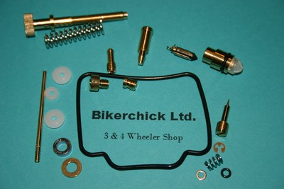

I'm just wondering what all is recommended for a carb rebuild, as the new carb I bought online still isn't quite right. I see some kits online with a couple things in them, but they don't seem to have as many parts as I think they should. I could be completely wrong as I've never rebuilt one of these before, but what do you guys consider necessary for a carb rebuild? I've got the original and plan to soak it in some solvent and get it nice and clean, then rebuild it. It's pretty bad, but I'll concoct something and get it as clean as possible before trying anything. It worked fine before the cam went, so I'm thinking with a rebuild and a few tweaks it should be good to go.

I don't buy a rebuild Kit unless I need multiple parts - if I need a float needle or seat, then I buy a kit that includes the needle and seat because the entire kit is cheaper than just the needle/seat at dealer price. I install the entire kit once purchased and either save the old parts as spares or simply toss the old parts separating the metals into recycle containers. When I buy a kit, I prefer Shindy, All Balls and K&L in that order, but have resorted to other brands due to availability. The only kits I truly abhor are Honda kits - Honda only includes the rubber parts, but sometimes certain rubber parts are only available in the OEM kit. i.e. - I just rebuilt a TRX450R carb - it had been previously worked on by a clown - parts were missing and nothing was adjusted properly. I got a Shindy kit and a Honda kit - the Shindy kit had all the jets, float needle, slide needle and needle jet, float bowl gasket, a drain screw o-ring, pilot screw o-ring and pilot screw. What the Shindy kit did not have that the Honda kit did have was the rubber plug for the choke feed well and the top cover gasket. The TRX450 carb has a fuel metering jet for the enrichening circuit in the side of the fuel well - the well is capped with a mushroom shaped rubber plug - if the plug is left out the amount of fuel available to the enrichener is unmetered - opening the enrichener for just one kick floods the engine. So, the rubber plug is required, but it never wears out and seldom needs replaced unless it is lost by a clown.
90% of all carbs I rebuild only need a few new o-rings and a bowl gasket. Float needles and bowl gaskets can be obtained from K&L Supply and other parts suppliers - the myriad of o-rings that need replacement I buy in bulk from an industrial supply where I can select the o-ring material. Example; the float needle seat is sealed to the carb body by an o-ring - the o-ring that comes with a needle seat or the o-ring in a rebuild kit are made of Buna rubber - Buna is a good fuel resistant rubber, but when exposed to alcohol it will first swell and then later shrink. Once shrunk, it will not re-swell, therefore is loses it's seal and fuel bypasses the seat to overfill the bowl and causes flooded crankcases, dripping from the bowl overflow, sometimes dripping from the float bowl vents and drained fuel tanks. I buy Viton o-rings for the needle seats - Viton is more chemical resistant than Buna and lasts much longer especially when exposed to alcohol. The o-ring is 7.1 mm ID x 10.3 mm OD x 1.6 mm material diameter. This is not universal - some smaller and larger carbs use different sizes of o-rings, but most 250 to 700 cc carbureted machines with Mikuni VM and BS carbs will use this size of o-ring.

Yep, as latebird said, you don't always need a whole kit but sometimes its more cost effective to just get the whole thing than to buy individual parts. It all depends on what you need.

Awesome thanks guys! Good to know about the o-ring size and material, as well as the preferred brands of carb kits you guys use. I'm not seeing much for Magnum carb kits, mainly just for Sportsmans which is par for the course. I'm looking at a Freedom County carb kit for a 99-00 Sportsman, it has good reviews and is a decent price. What do you guys think? I can always run to Polaris if the jets are different or something, but I think it should work for the most part eh? There were kits that covered more years, and also one that listed an EFI model as a fit, but I'll stick with the same year at least.
