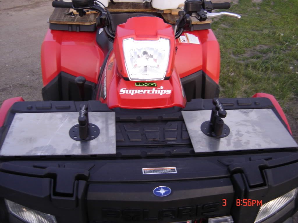

i ordered my rotopax gas packs on sat night along with the alum mounts. i got them today. vary nice i may add. im gona mount them to the front rack. my idea is a bit differnt. but pretty much the same idea. i whent and got 2 sheets of alum today. costed $7.50ea.... i got a great deal on them i may add.
but now that i look at the pic. i wonder if i can get by with one alum piece. guess im gona have to check today.
anyways. i dont like to drill any more hole than is already in there. i prefer to use oem holes. this way if i want to change my mind. there wont be holes in spots i dont want them to be. plus it wont leak.
im gona get 8 stainless steel bolts to replace the oem screws holding the black rails on the rack and use the oem hols to mount the alum to the rack. i will also use spacers to hold the alum off the rack to prevent wear on the plactic. im also gona remove the bases on the rotopax mounts so i can mount them right to the alum. this way it will be a nice clean look. and i wont have a bolt head on one side and a nut on the other.
i do wish the packes were 2 1/2 gal so it adds up to 5gal or 3gal ea to add up to 6gal. but quess the 500 arent as big of a pig on gas as the bigger atvs.
heres a look at it just sitting on the rack. lookes better than a regular 5gal gas can.

i used i beleve it is 3/16" thick alum. only paid $15 for both. i used all stainless steel screws. and nylon spacers. everything is counter sunk or least flush. this way the screw heads wont wear on the rack or the rotopax gas packs. i evon rounded off all the alum edges with a file. ya i spent some time on it. kinda wish the front rack was lock and ride. then i didnt have to leave the mounts on there. but oh well. the rotopaks are heavy duty and if need ill just stack on top. i also made shure it didnt hit the headlight when turning, and i didnt add wasers on the other side but i may just add a regular stainless washer on each rail/alum mount bolt on the inside of the rack.
but heres mine mounted...
and the alum and mounts..
i am also thinking about now getting 4 longer stainless screws and mounting the oem bases back under the stands....... hummmm
i will add pics of the support straps when i get them on in a few days.
i just thought sbout this. soon there wont be much for me to add. ill have to get a new wheeler and start over. lol

ok. got some other pics of the mounts. i added the oem bases again, and i added support straps to the front. they were cut from regular rachet straps....
Man you do have some time in that, looks good!
50 Posts
That setup looks great. I've got mine ready to mount, I used a single sheet of aluminum 1/2" so I could countersink everything. I appreciate all the thinking you put into the mounts, it made it easier to mount my own. I was lucky, the 550 already has the support straps.

I did something similar. I went with one piece of aluminum vs two. I made it a easy on and off system by just removing 4 small stainless screws when not in use.
49 Posts
Thor - I like the diamondplate look. How did you mount the diamondplate to the rack? (did you screw through the plastic, or just clamp to the bars somehow?) Also, did you do a similar strap setup as Chuck inside the box?
