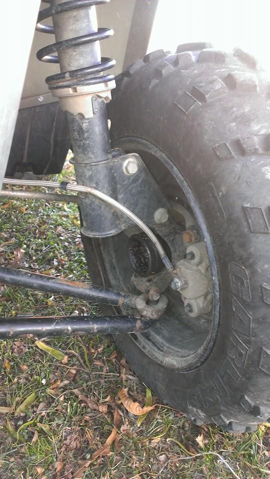

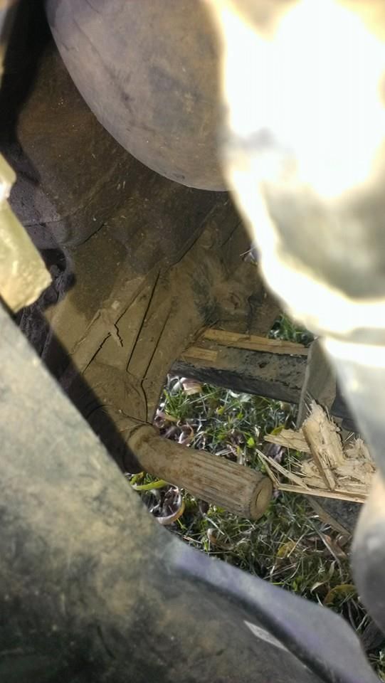

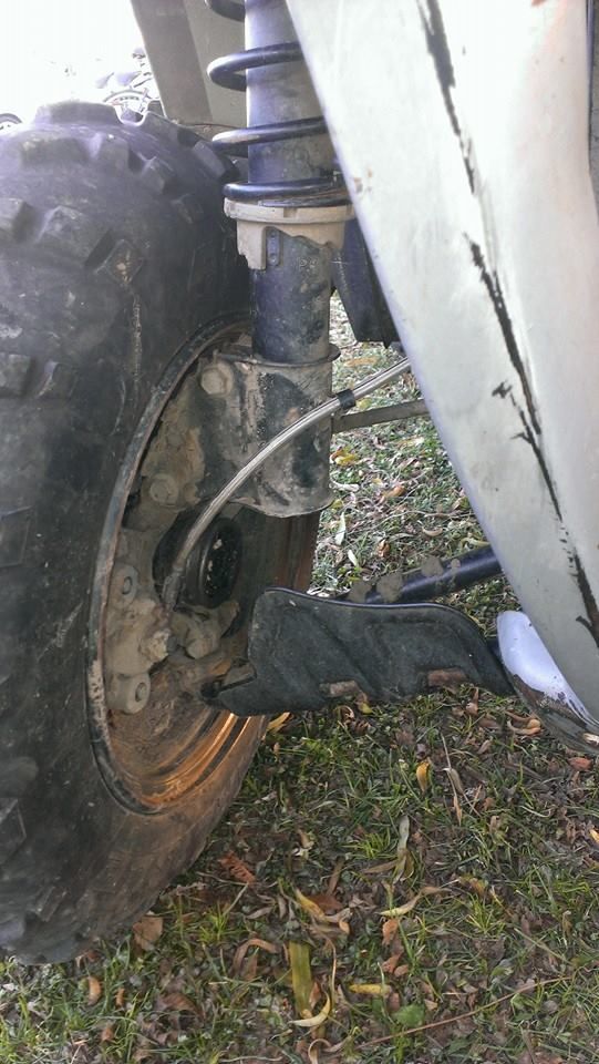

picked up a 2006 hawkeye 300 for almost nothing the other night, but heres the catch, the p.o. claims the prop shaft got bent, so they pulled it, then realized that wouldnt allow the front to spin, so they pulled the front cv joints, and drove it like that,
now thats the story, so i have the good cv joints, but no prop shaft and this is what the atv looks like
any help will be appreciated, im curious if a sportsman prop shaft will fit in this?

pretty sure wheels will spin with or without the propshaft. Sounds like there is an issue in the front diff. Either way its worth fixing it.
