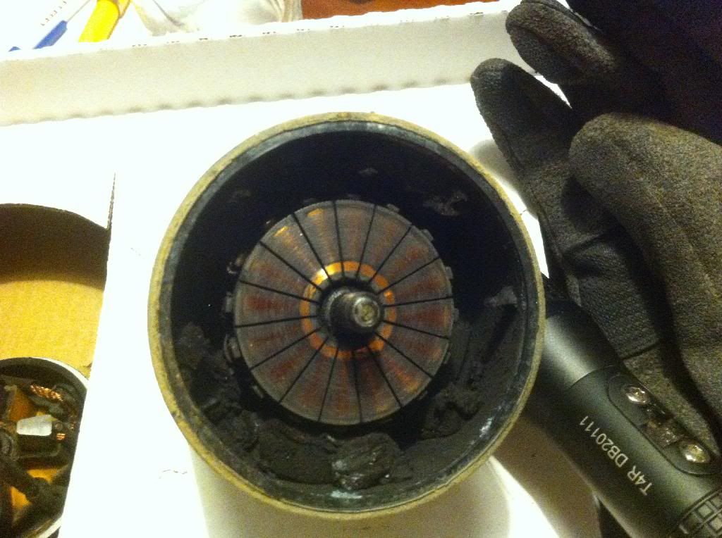

I was out plowing yesterday when my winch started killing the engine, I had been plowing for an hour or so, I figured the battery was low. I parked it and put the battery tender on it. Started it today, plowed for 5 minutes and the winch stopped working and would draw enough power when you pressed in or out to stall the engine. The winch motor made a loud whining noise too. I took the motor off, looks to be completely destroyed inside. I don't know much about electric motors, but I believe this to be a permanent magnet motor. It's $119 for just the motor through polaris, guess ill start winch shopping. Looks like one of the magnets on the inside broke loose and wadded everything up.

I have had this in the past with starters. If I had to guess you got a bit of moisture in the winch and it froze the armature to the magnets. You hit the winch and the mechanical force peeled the magnets off the case. The magnets are spot welded to the outside of the case. I have in the past re-glued them with special Loctite 480 but I would not do it with a winch. It is not really a manufacturing flaw but in my mind a design flaw. For the record before anyone does the Polaris cheaped out thing my Warn is built the same way.
You can get starters and probably winches that have the magnets mounted on the outside case and they are sealed in epoxy with an inner sleeve so that the magnets can not freeze to the armature but I don't know who makes them.
For $109 I would go buy the motor from Polaris or find one online somewhere. Cheaper than a new winch and having taken my Polaris ones and Warn ones apart they are virtually identical except for the freespool button and in my consideration quite substantial.

I don't really plan on buying the motor from polaris. I'm eyeing the super winch Terra 3500 with synthetic rope. I have my brother looking into getting a motor, but he isn't having much luck. He said he could fix the one I have if the magnets were intact, but they aren't lol
