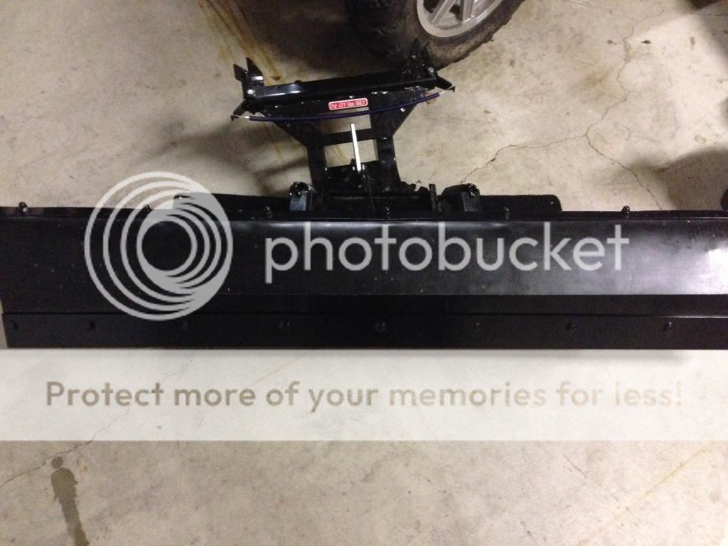

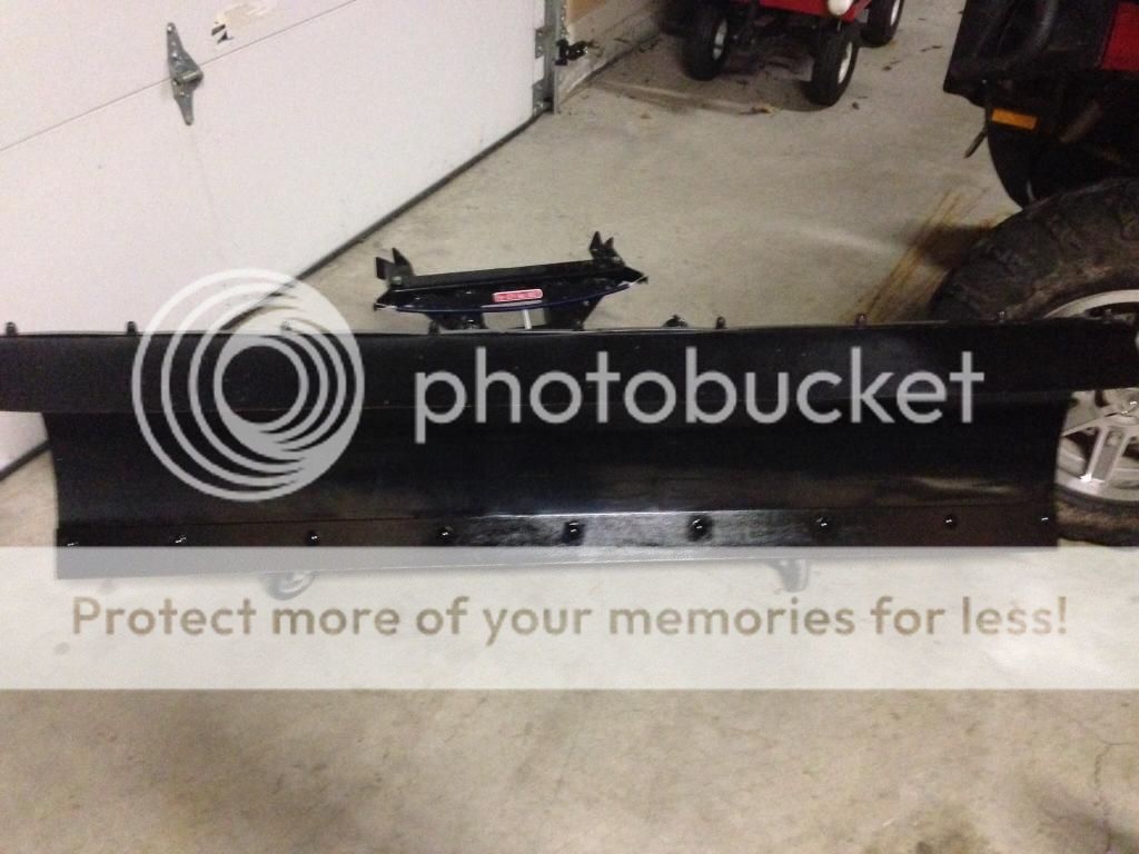

After plowing my over sized driveway and private lane last winter. My wear bar was shot and worn down to the plow body. I even flipped it so both sides were worn down. So over the summer I made a new wear bar out of a 1/4" x 4" x 60" piece of cold rolled steel. I just used it twice this week and it worked perfectly. Zero signs of wear.

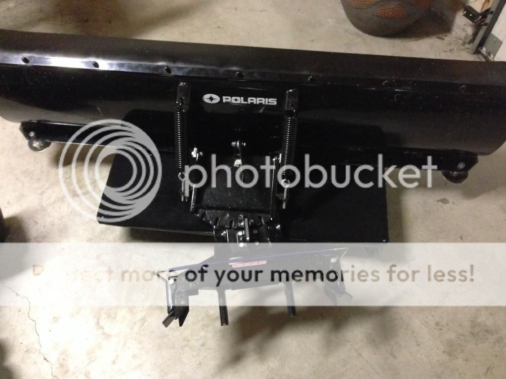

This next photo shows my Plow Cart.
This makes mounting, dismounting and moving a dream.
The plow frame lines up perfectly with the atv front plow mount. I just have to wheel it to the front of the XP and push it in to engage the frame mount locks.

Your homemade cutting edge looks good.... wouldn't even know it wasn't factory if you didn't say so!
I wear out the skid pads. I adjust for 1/4" of space between the wear bar and the ground.
I'm with Cline.... I set my pad 1/4" lower than the cutting edge, so I wear out my pads before the edge. Mainly because I'm not plowing a solid surface, as my drive way is crushed asphalt amd the alley way is gravel.
Note: I use a 5 gallon pail stur stick from home depot to obtain the 1/4" spacing. I place the stur stick under the cutting edge and adjust the wear pads down to the ground (garage floor). It's easy to replace these or weld a new bad to the base of them if needed.

This is not an option for me. My drive is very shaded and steep. If I leave any snow behind it will turn into an icy mess. Been there done that. I used to plow with a 1978 John Deere 400 that things wear bar lasted me 15 years and it rode every inch on the asphalt. The engine finally went so I sold it and the xp has stepped up to take its place.
So if this wear bar lasts that long it will be well worth my time and very small $ investment.
Ahhhhhhhhh....... asphalt. I'm plowing gravel with a few bigger rocks embedded here and there.
