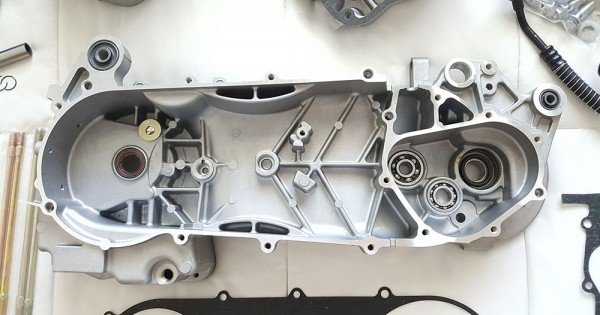

Sorry it’s been a while. I put a ton of performance parts on it and just got the power commander installed I can give you a list of the parts that I used but there is a caveat to it.
1. Clutch upgrade. I purchased a clutch kit for it with a higher rev spring. It now engages at about 4000 RPM which helps with turning the larger wheels that I have.
The part that I bought is right here-
And
Performance torque driver for Polaris RZR 170 ACE 150 Ranger 150 US TW | eBay
I talked to the guy andGave me the higher spring for free.
2. Oil cooler, and 170cc tadia cylinder with larger heads and a performance cam. Bought it all from
Be forewarned warned!!!! You have to remove the head and measure 2 critical parts!!!!
mine is a gy6 a block short case. There is literally 20 different variations of this motor!!! Make sure you do the work and measure before you buy! The guy at gy6 store is super knowledgeable to.
A good reference to show what yours is is here -
Stud spacing will be a definitive tell but your opening size on the case will tell you how big of a kit you can get. I had about 62.7 mm.
3. I just installed a power commander and wide band kit to control the fuel flow. Just installed it and will let you know the final results in a few weeks.
4. Windshield, roof, hard doors, and a 2 in lift. I have Purchaced 26 in tires in the back to increase clearance from the bar by 2 in. I only insIf anyone wants info on any of this I will share where I got it.
I just installed everything. I have to tune it to have results. I will post pictures and results in a few weeks.
Good luck!

Can you please let me know the exact part numbers of everything you ordered. sprockets tries clutches. Everything please!!!!!!! I keep ordering the wrong stuff
If you contact the gentleman at the GY6 store he is an expert on these engines. https://www.gy6store.com/. As i warned in the above post there is almost 20 different versions of this engine. The only way to be sure is to take it apart as outlined in my post above. as far as clutch parts a the one i purchased is also outlined in the post above. power commander only sells 2 products that fit this.
