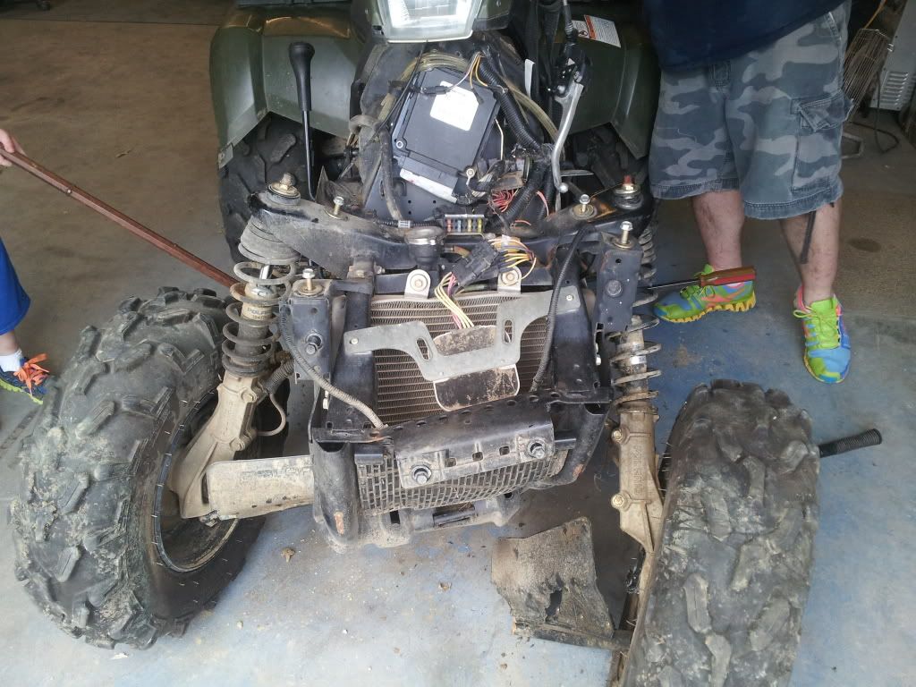

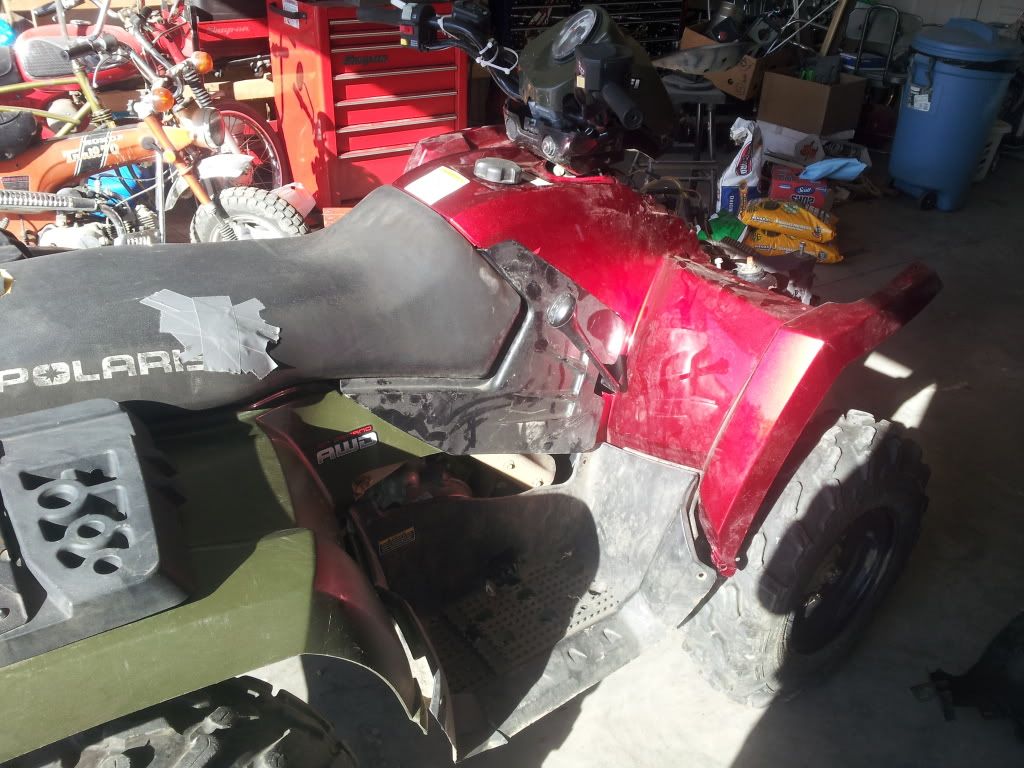

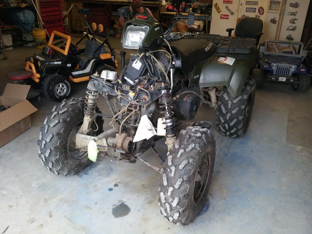

Well this is my first build thread and im hoping that starting one will keep me motivated to get this done in a reasonable amount of time lol. A little back story, my best friend bought this 2008 sportsman 500 efi brand new, around 2010 he let our neighbor borrow for a weekend and his son ran into a light pole going pretty fast. well my buddy just parked it in a field. It sat there until I bought it from him in 2013 for $200. I wish I would've taken more pictures from the start but I didn't think id be this far into it. the wheeler got hit hard on the left front side pushing the wheel back into the footwell. I thought I could use a backhoe and a tree to straighten the frame but I just wasn't satisfied with the results.
before
after
so I bought a new frame, an a arm and shock, front plastics, front brake bracket, oil tank, front metal bumper, starter and recoil cover which someone stole, and swapped everything over last fall which gets it to this point

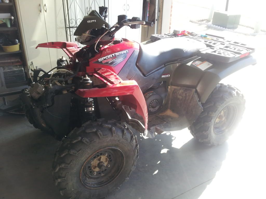

welp I got my plastics painted. plastidip is an ok product if you have the patience to use it, I myself have no patience when it come to paint. I put down 9 cans of plastidip and decided I didn't need to wait the 24 hour cure time before I installed them. well I nicked them so I have some spots to touch up. but heres some pictures
