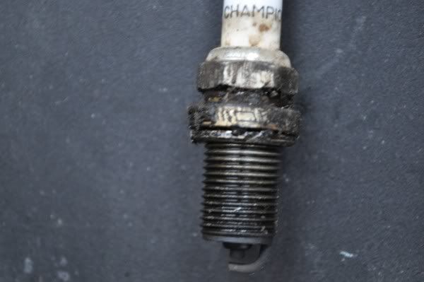

Ok, so I wanted to take out my sparkplug and see what kind of condition it was in. Since I bought the quad in March, I've been slowly going over just about every square inch to try to get it back up to speed. So today I tackled the greasing (except for those 2 pesky ball u-joints) and then the sparkplug. My question is, why is there what looks to be mud or gunk on the threads and just under the threads? Surely this can't be normal. So how does one clean the inside of the sparkplug area. I was able to take the sparkplug out by not removing the gas tank, however it was a real pain in the butt as the sparkplug area only gives me about 4-5" of clearance between the bottom of the tank and the top of the motor. JUST enough to get my hand in there and get a plug remover tool in. Any suggestions?

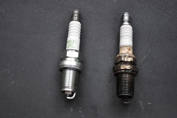

The one of the left is what the PO gave me as a replacement. Gap size should be the same, right?

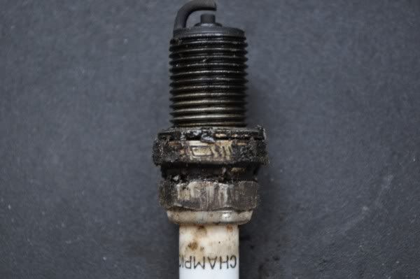

The mud/gunk on and below the threads.

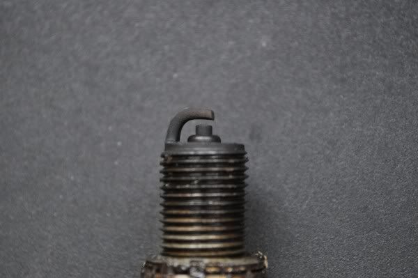

The tip doesn't look fouled at all, some carbon is all. Suggestions on if this is ok or if I need to do something?

All the mud looks like it is above the cylinder, like it had been sunk before. As long as none of that crap is below the threads I wouldn't worry. Just looks like carbon build up on the threads and electrode.

I hope you cleaned out the spark plug hole before you removed the spark plugs, but it looks like you didn't. All of the mud in the holes falls into the cylinder and even more falls in when you try to install the new plug..... Not sure what else to say but I wish you luck

The port or hole the plug came out of should have been cleaned out with compressed air to avoid the debris from entering your motor.
Now you know, hopefully no harm done.

I agree with Bigdog. The first thing I see wrong is a Champion spark plug. The NGK you have is the best. The gap should be set at .028, I would leave the spark plug out and hit the start button a couple times to blow out debris before putting a new spark plug in.
