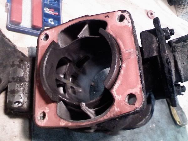

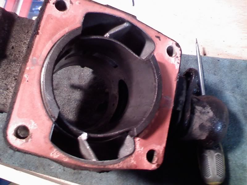

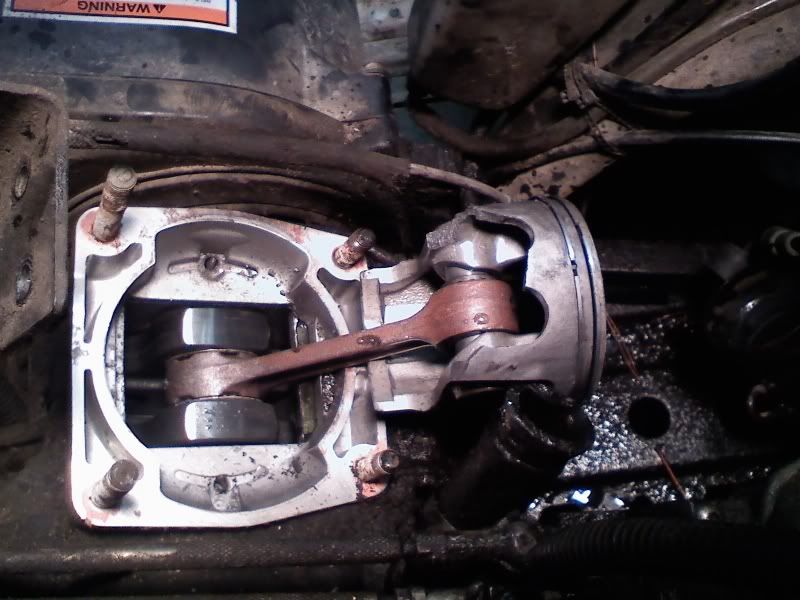

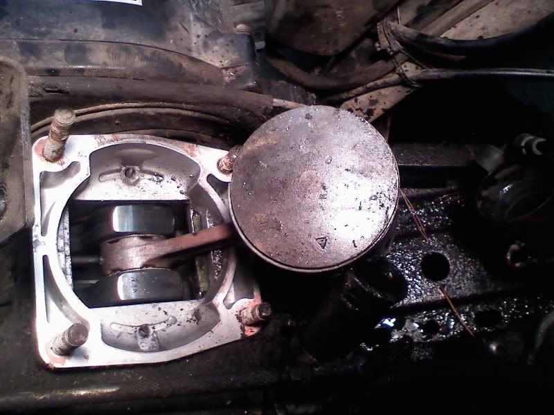

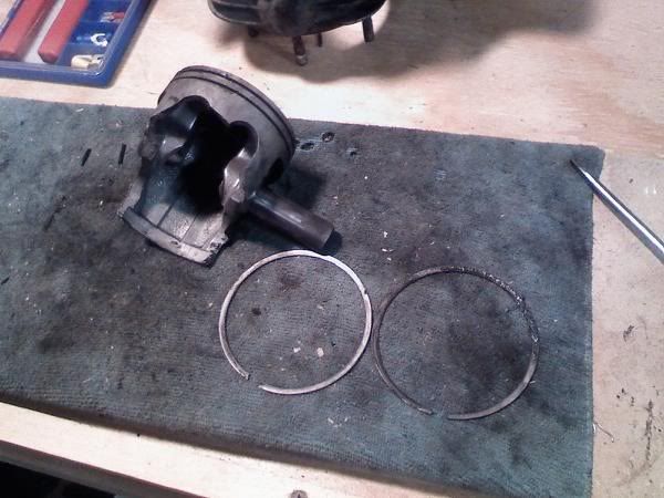

So my wheeler died on the trail...we opened it up and took a look...come to find out the piston skirt was shattered....however the top and ring were untouched....the cylinder walls look great!
My guess, the guy I got the wheeler off of realized an issue began...I am guessing he decided to get rid of it before something big happened...well it happened...it had light compression but still ran strong or somewhat strong...It looks as though the skirt began to break away and slowely sontinued to break and discharge through the exhaust over time...finally a big enough piece came off to jam the piston and drop the compression th about 57psi....
Any idea what could cause this? What do I need to do to prevent it from happening again? Here are some pics if this helps any of you to diagnose for me thanks.
