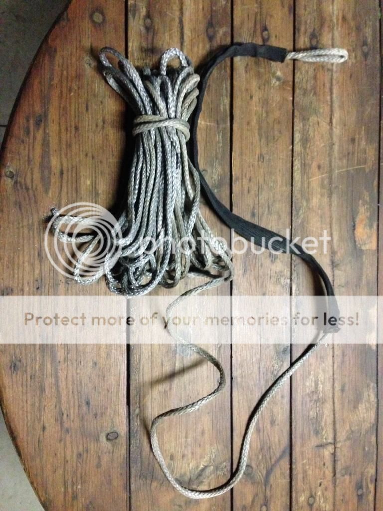

This is my 3/16" Wire Cable after 1 year never used to plow. It broke on a pull out of a peanut butter like mud hole. Luckily I had is heavy towel on it or it would have taken my buddy out.
This is my 3/16" synthetic rope after 2 years of use.
Has been used a lot more then the cable and looks almost brand new.
I do not use it to plow with I switch to a 10' plow rope for that.
