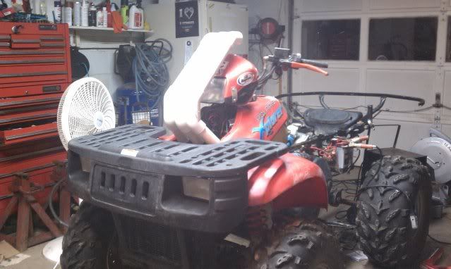

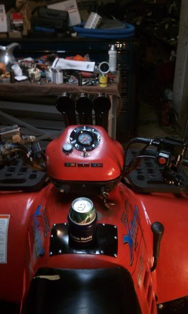

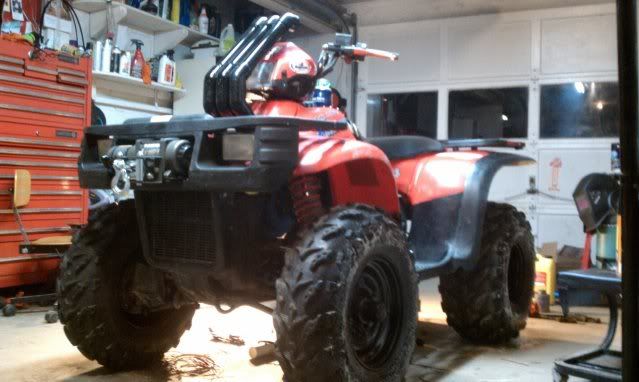

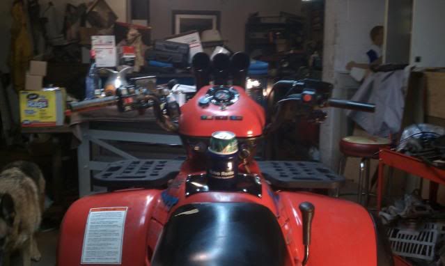

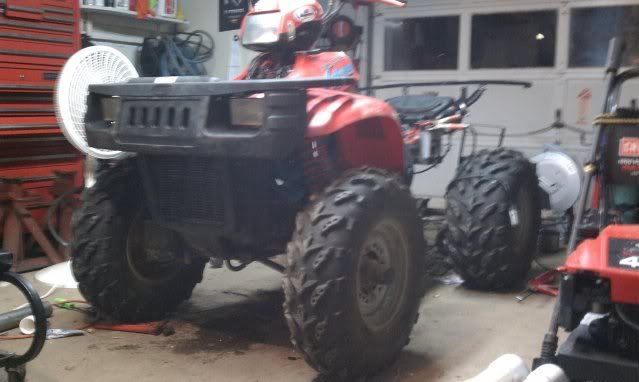

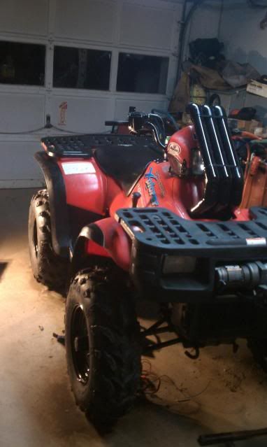

ok, I havent posted in a while but i got thewater pump seals in, filled it with coolant and started it up, also got the oil block off installed and the carb rebuilt, then it was onto the snorkel untill my stage 1 pipe gets here. i know you guys gave me some snorkel input, but i went a different way. here are some pictures, let me know what you think:
IMAG0243 by muddinredneckcj5, on Flickr
IMAG0251 by muddinredneckcj5, on Flickr
IMAG0250 by muddinredneckcj5, on Flickr
2002 front end on 1995, it does fit!
IMAG0249 by muddinredneckcj5, on Flickr

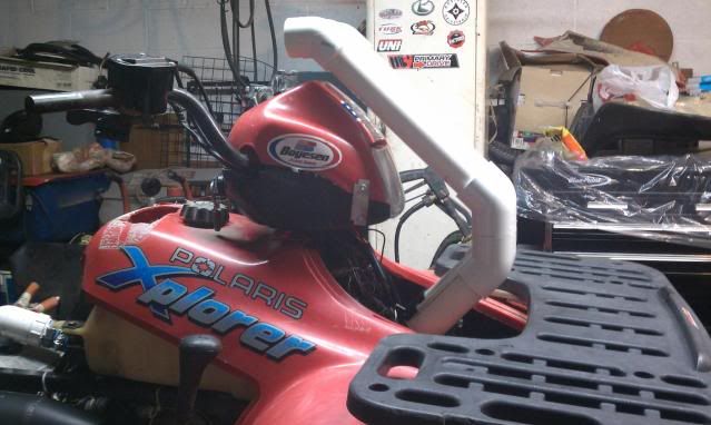

My snorkel bracket:
IMAG0271 by muddinredneckcj5, on Flickr

hello i was woundering if you could tell me what size the pipes are on the snorkel and how my ebows you used . i rly like what you did to it. i wanna do it to mine but dont know how to do it that nice like you did.. and you do that carb lines also ??? did you move the oil tank or you mixing it if so what you mix it too 40 to 1 ?
thank you.
