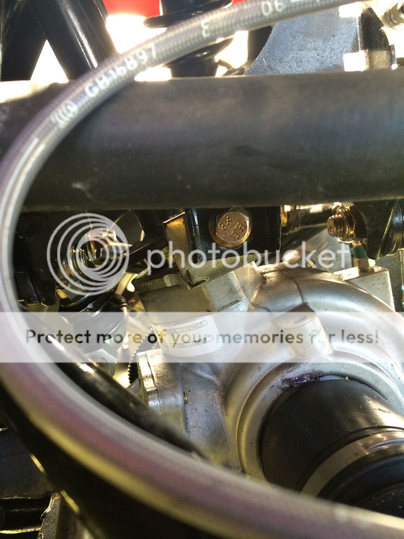

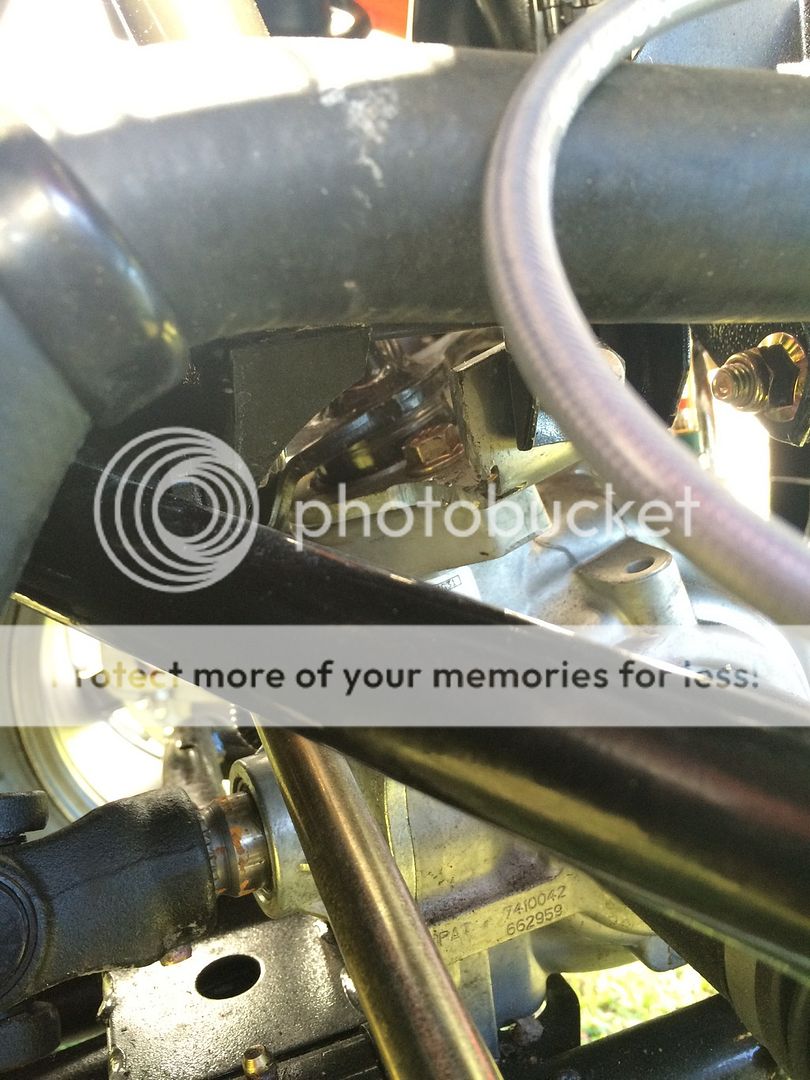

I may have solved the issue to the poor turning radius on the Polaris sportsman 850 highlifter edition. Some may call me crazy but I got tired of taking a football field to turn around.
There is bracket on top of the diff where the tie rod ends contact and stop. It is a factory bumpstop that Polaris puts on because of the bigger tires and no sway bars. I took my steering apart and cut off the flange pieces that stop the steering from turning as a sportsman should.
My dad has a 2014 570 and I can turn just as sharp as his now.
I have used 4x4 and rode threw trails and ditches with zero issues or binding.
I love it!
here are the pics
you can see here my poor grinding skills
edit: I have posted the wrong picture. But this is a full locked picture. I will post a picture of my dads 570 for turning comparison. Don't get me wrong the turning still isn't what it should be but it is a lot better than it was stock

Now you have to worry about binding your outer CV when at full lock.
#4 ·
You mistake my observation for concern. I don't care either way. Just observing that there might have been more than one reason why the stop was designed the way it was. Might just be limited to that radius simply because of the added height of the tires and HD springs accompanied by the additional body roll created by the omission of he sway bar. And anyone that knows anything about 4x4 atv's knows that you don't need to be at throttle to bind the joint. It turns the entire time the tires do which means if you are rolling and turn too tight you exert rotational force on that joint. Good luck though.

I measured the amount of steering turn I have on my 2016 HL to the steering on my dads 2014 sportsman 570 with a 2in lift. the steering radius on the bikes are very close, his might be a little tighter but its so much better. But I measured and studied the axles shafts also. My CV joint lower and upper are the at the exact same angle as my dads. So shouldn't wear out any quicker than a lifted sportsman. My dad drives his like a bat out of hell and has never had any joint issues. :rambo:

I just reread your initial post and realized that you are not at full lock in your pictures. I misread the first time through and thought you were. That CV already looks to be in pain. I'm not even sure I would give it two weeks. Maybe two rides? Again, I don't care but don't start another thread later when Polaris won't honor your warranty on your axles or steering stem. Also hope you don't end up hurt trying to ride it like a sport bike. Best of luck to you.
#12 ·
I am at full lock in the picture. I posted the wrong picture, that is as far as it goes before it contacts the bumpstop bracket. I need to edit my post. (I will now) It is not any sort of bind at all and it only turns about an inch more than it did before. If it is in a bind than so is my dads sportsman 570. So if it does put extra stress on the cv, it will be no more than a lifted 4x4 atv. Ill take those odds. Now it turns a little less than an lifted Sportsman. I have ridden it several times since I did this two weeks ago. I promise I will test it to the extreme and be smart while riding just like any other atv.
And I'm not one of those people that would call Polaris and beg for a new shaft. I appreciate everyones feedbacks though. I have put a lot thought into this. I studied long before I cut anything on my new 2016 4wheeler. It still sucks turning though but its a lot better than stock.
