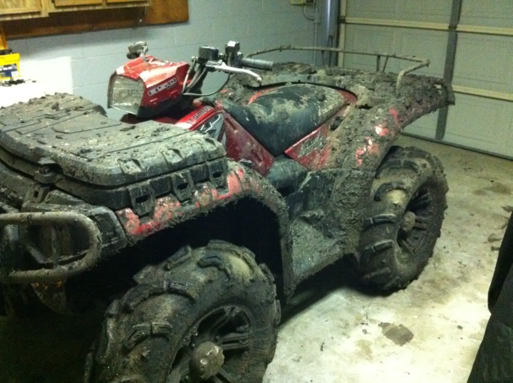

Just built my own brackets, like you'd buy. The rear I modified with a bend to clear the frame. I'm trying an idea to replace stock bushings with rubber. I've just done the rear to see how long they last. The other option for bushing material would be polygraphite. My buddy's grizz bushings are rubber and his quad is 4 yrs old and still no play in his suspension, not to mention a very smooth ride.

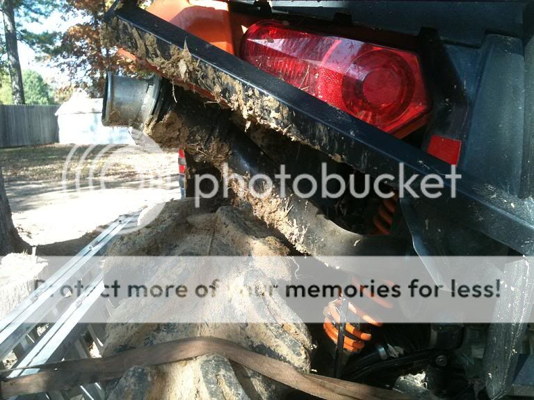

Moved the exhaust up to get it out of the mud. I hated how low it came out. So here it is, I had the two stock openings welded closed, then added a 2" exhaust and extension out to the side of the XP. At the end I used an HMF tip and spark arrestor. IMO, it sounds as good as any HMF exhaust Ive had and its still fairly quiet.
