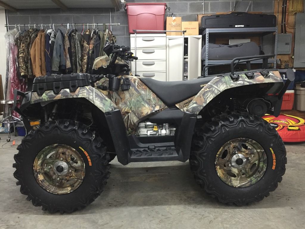

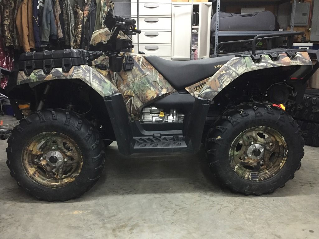

Well, the Bearclaws were on the back porch when I got home last night and a QSC clutch kit was in the mailbox. I was able to sneak away from work today and get everything installed. Snapped a quick, before and after, cell phone picture. The first pic is the factory 26" Carlisle tires. Second is new 28" Kenda Bearclaw HTR.
Bob, I haven't gotten a chance to put her through her paces but the look is exactly what I was hoping for. 28" looks great on this size machine. It looks like I still have plenty of clearance around the tires, looks like nothing can rub. I REALLY love the additional ground clearance they give me. With the factory tires I had 10-ÂĽ" from the lowest point of my skid plates and the ground. The Kendas took it to a hair over 12". (the tires are overpressured right now, will prob lose a little when I drop them down to riding pressures?). Surprised me when I went to step-up on the machine and almost flipped over the other side when my foot didn't clear the footwell.
Don't know when I will get a chance to get her on a trail but around the farm the handling is much improved. My biggest complaint with the Carlisles was the way the tires would roll when cornering. No roll with the Kenda's. Had too much pressure in the tires to really comment on ride. They were much smoother than I was expecting at low speeds, I think they will be perfect around 5 PSI (any opinions there?).
The clutch kit has done exactly what I was hoping. I wasn't hoping to be able to wheelie, I don't care about my launch, I merely wanted my machine to feel the same with the larger tires as it did with the factory. First impression, Ryan with RVS Performance nailed it. Shipping was fast, his YouTube installation video is awesome. I would normally take it to the shop to have something like this done. His video made it look so simple, I had no problem installing myself. Too soon to say it is perfect but I am very happy with the results so far. I added 45 lbs of tires and I can't tell it. Low and mid range feel good and snappy. Normally hit 54-55 mph on straight stretch in front of the farm. Speedometer was reading 49-50 with the new tires. They are larger tires so I don't know how that equates. Feels as fast as I want to go and I am happy.
