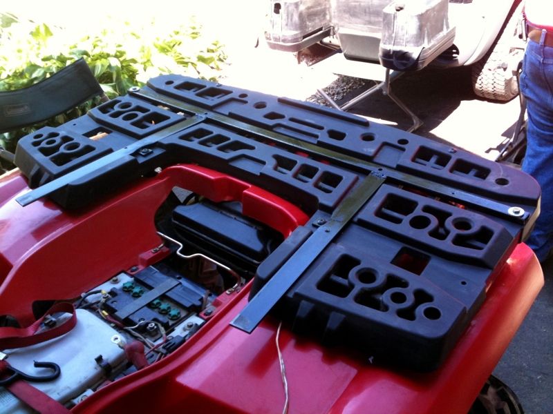

My wife has a issue with the distances we travel and the time we spend on the trail. Physically its too much for her. BUT she enjoys the sites and good times associated. SO, she is relegated to passenger status for these longer trips.
I was kinda expecting this and so I bought the bigger machine... My 700.
We have a trip coming up in three weeks, so I swapped boxes with my pop and am using his Moose Executive rear seat box and made up foot rests. I first made a frame in/on the factory rear deck. Using some 3/4" square steel, a piece of 3/16x1 1/4" flat stock and a bit of 1" x 1/8" angle iron.
I tied into the rear framework and the inner bolts to stiffen up the whole rear rack. My reasoning for all this is hand holds. I will be making some for the rear passenger as well as the actual foot holds.
I took more 3/4" thin wall steel and followed the contours of the rear fenders down to the foot wells. At the foot wells I used a piece of 1/4" x 1 1/4" steel. I drilled to match two of the factory bolts.
I attached the frame work into these.
Then I had visions of folding pegs... Some-one's factory pegs... something trick... But the minds eye isn't reality... I ended up making my own rigid pegs. They turned out VERY sturdy and relatively out of the way to the pilot.
I have since shortened this up by 1/3. They where longer than needed.
It's held on the machine with ten bolts, five on each side. I atteached the seat box by tapping four holes in the new frame work so its attached form inside the box. Here is the frame work off the machine.
Then with paint...
I had to have 12V in the box as I found it very usefull in my Sportsman box.
I am not going to keep this box, I'll likely be calling Thor before the end of the season for a WES box.
Tell me what you think!

Well I had some time today and the weather cooperated so I cut and tacked on the hand holds. I also got momma up in the seat for a trial fit. I was rewarded with a compliment... " OH, this is VERY COMFORTABLE!" Guess I done good so far, the "boss" like it!! ;)
I cut the hand holds at 13" high and pinched one side so it would fit better on the 1" angle iron. (The hand holds are 1 1/4" dia.) Then I angled them slightly back towards the box. I need to be sure I get clearance to open and close the box. I also found that the foot pegs are still a bit long. Allowing my foot to slip between them and the bike. This could be a problem in rough terrain hurting the legs of the pilot. I trimmed them as short as the brackets allowed and rounded all corners. If they still prove too long. I'll have to remove them and re install outboard of the down pieces instead of transecting them. This will gain me about 3/4" as well as allow for more of a "bite" for the passengers heel. I may have to change them anyhow as she thinks they are a bit smooth.
Here is a couple shorts as it came together...
Here is the hand holds in position just prior to tacking them in.
Gotta finish welding tomorrow or the next day then shoot it all black.
I also added a fender bag to the very back of the box. I used two footman loops for the top:
The attached the bag and attached the lower straps to the bumper. its kinda like a back pack. Hope it dosent get too dirty back there...
